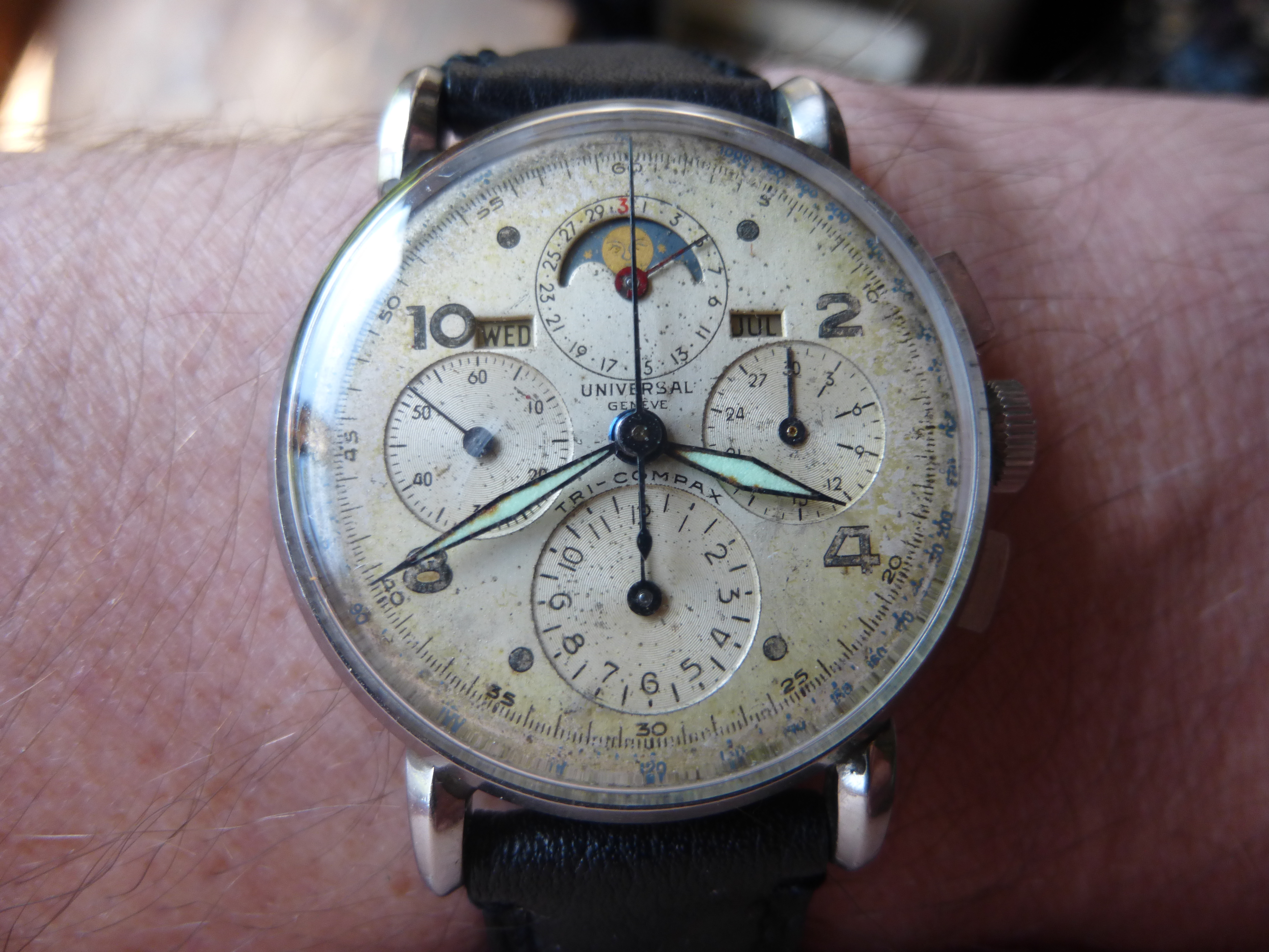

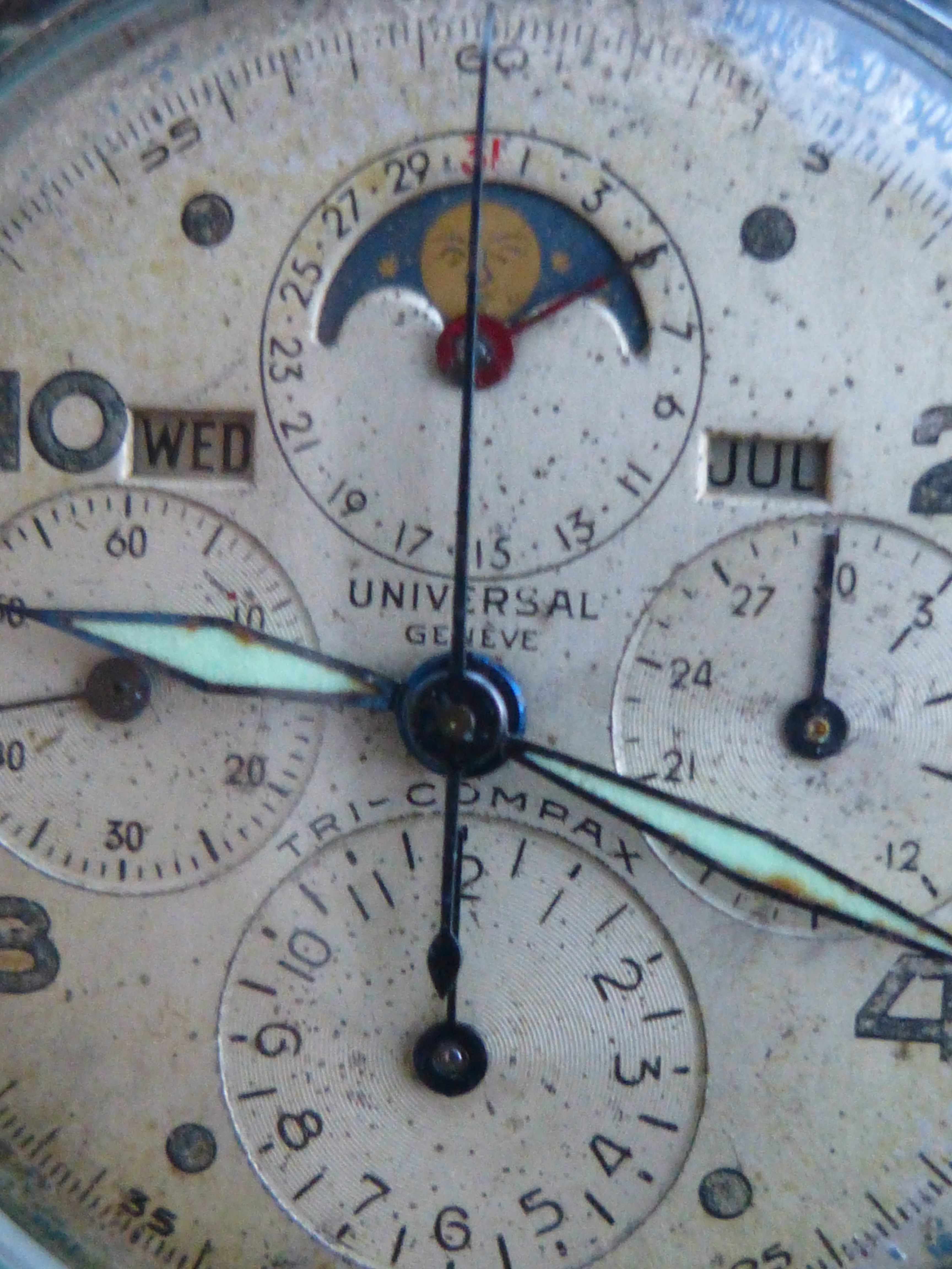

    Hello,
    new to the forum I wan´t to share some beautiful pictures of my vintage UG Tricompax. I was able to buy it from a collector two month ago from Austria. He took the photos for his ad, so I felt in love ... Starting my little collection two years ago with some Valjoux chronos, I couldn´t resist. The watch was serviced last year so the movement is in good shape.
    Reading through the threads here I realized that in that forum are really some experts and addicted like me.
    So what do you think about my "new" watch, does it looks all original to you?
    Have a nice weekend and best wishes from Berlin
    Georg
    Waynepjr likes this.
  2. woodwkr2 Apr 11, 2014
    1,366
    819
    Welcome Georg.
    That's a beautiful Tri-Compax that you have there. Those spider lugs are really special and don't look to have had too much polishing. We've seen a few examples with spider lugs come to market of late, but I think that's unusual, as I generally think that they are much scarcer than the more traditional lug designs out of Universal. I personally, ascribe a higher value to them. To my eye, these examples belong in the same category as the similarly styled Vacheron and JLC pieces from the same era, with Universal perhaps having an edge in technical superiority with the complications of the Tri-Compax. Though Universal branded movements were not finished to the same degree as the other two.

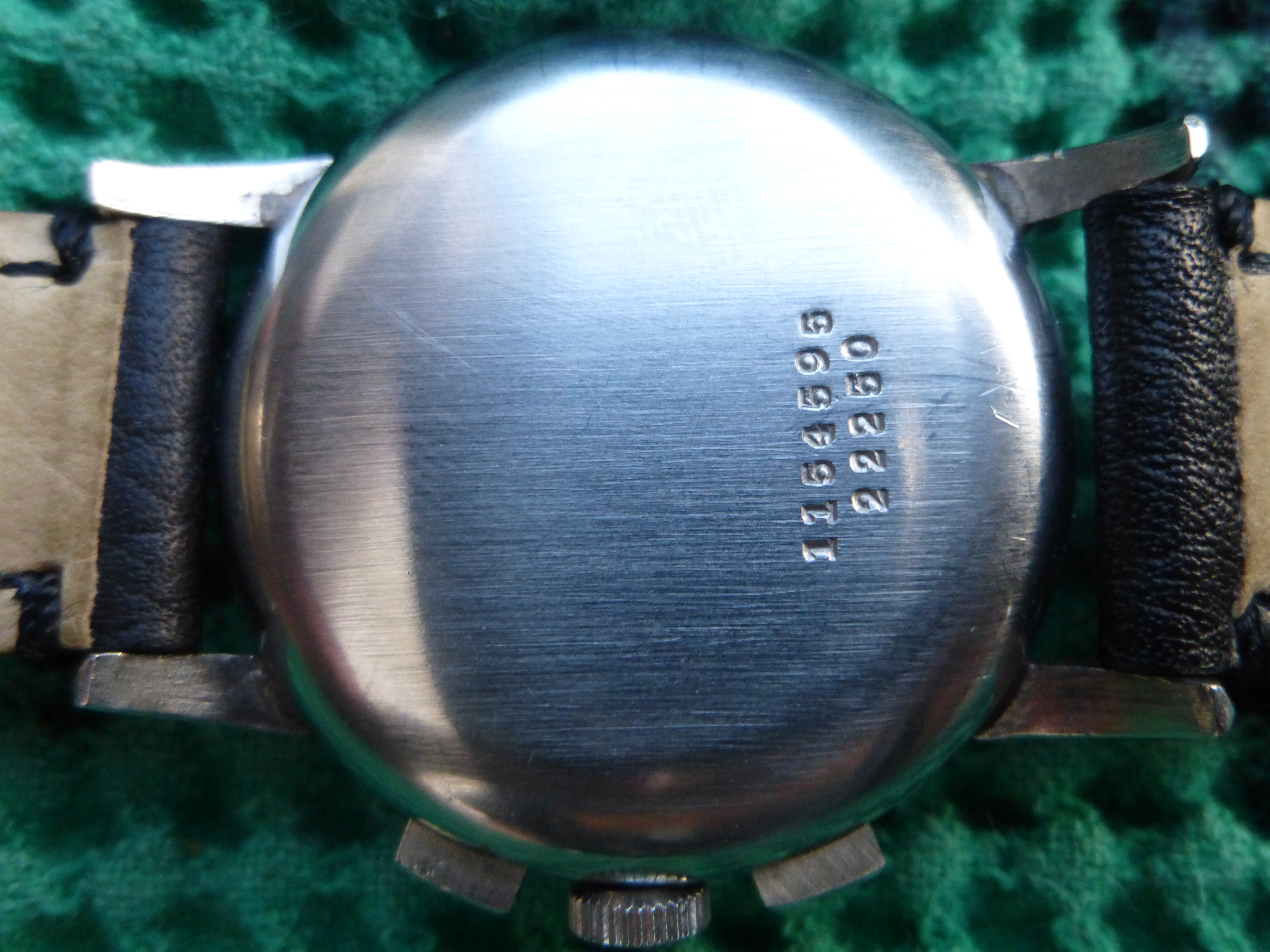

    Everything visible in the picture appears to be original and correct for that reference. Just the crown that isn't really visible.
    The hands look like they've been relumed at some point in the past--although they can sometimes appear more green than they truly are if a flash is used in the photography.
    It's so nice to see a beautiful, original dial--even with patina.
    Based on the case numbers, your example was likely produced in or around 1945.
    Congrats! Keep her away from the polishing wheels ;)

    Very cool, just saw this, love the fact that nobody saw the dial patina and tried to re-finish it

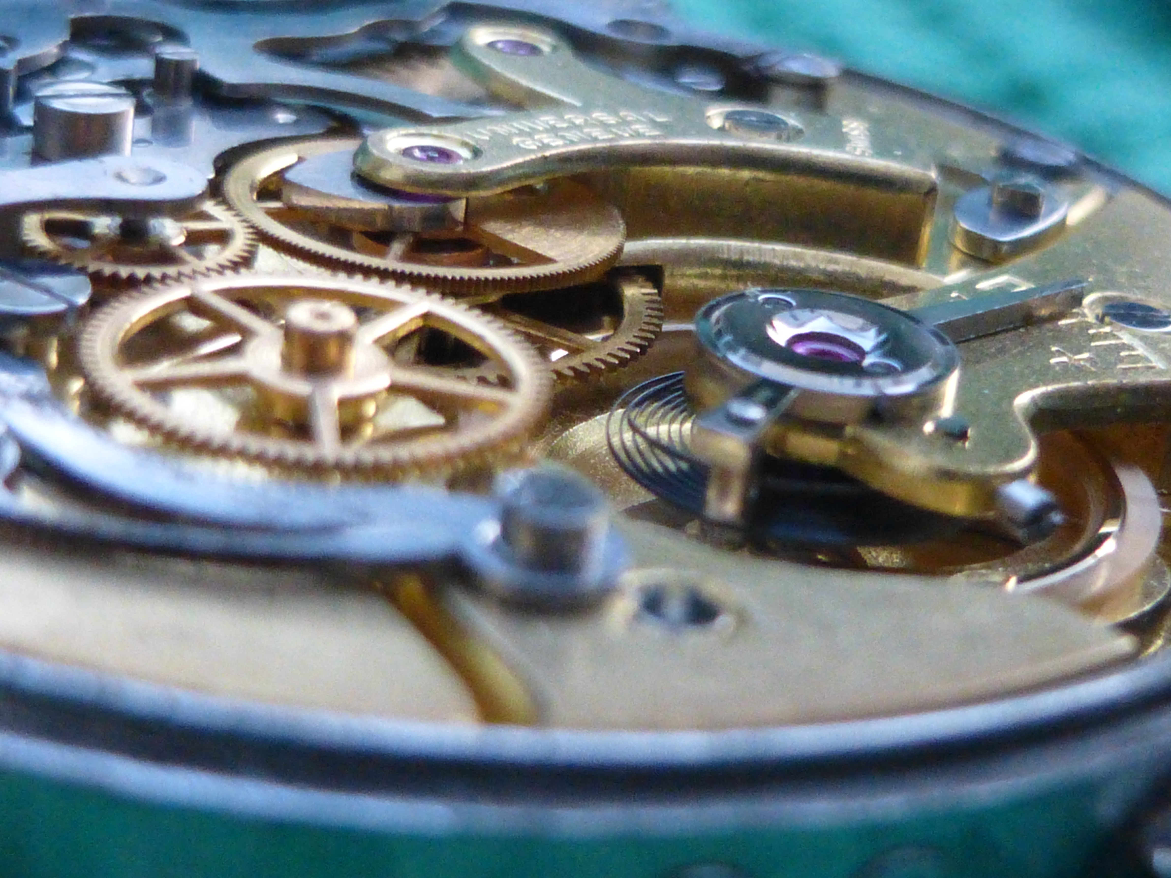

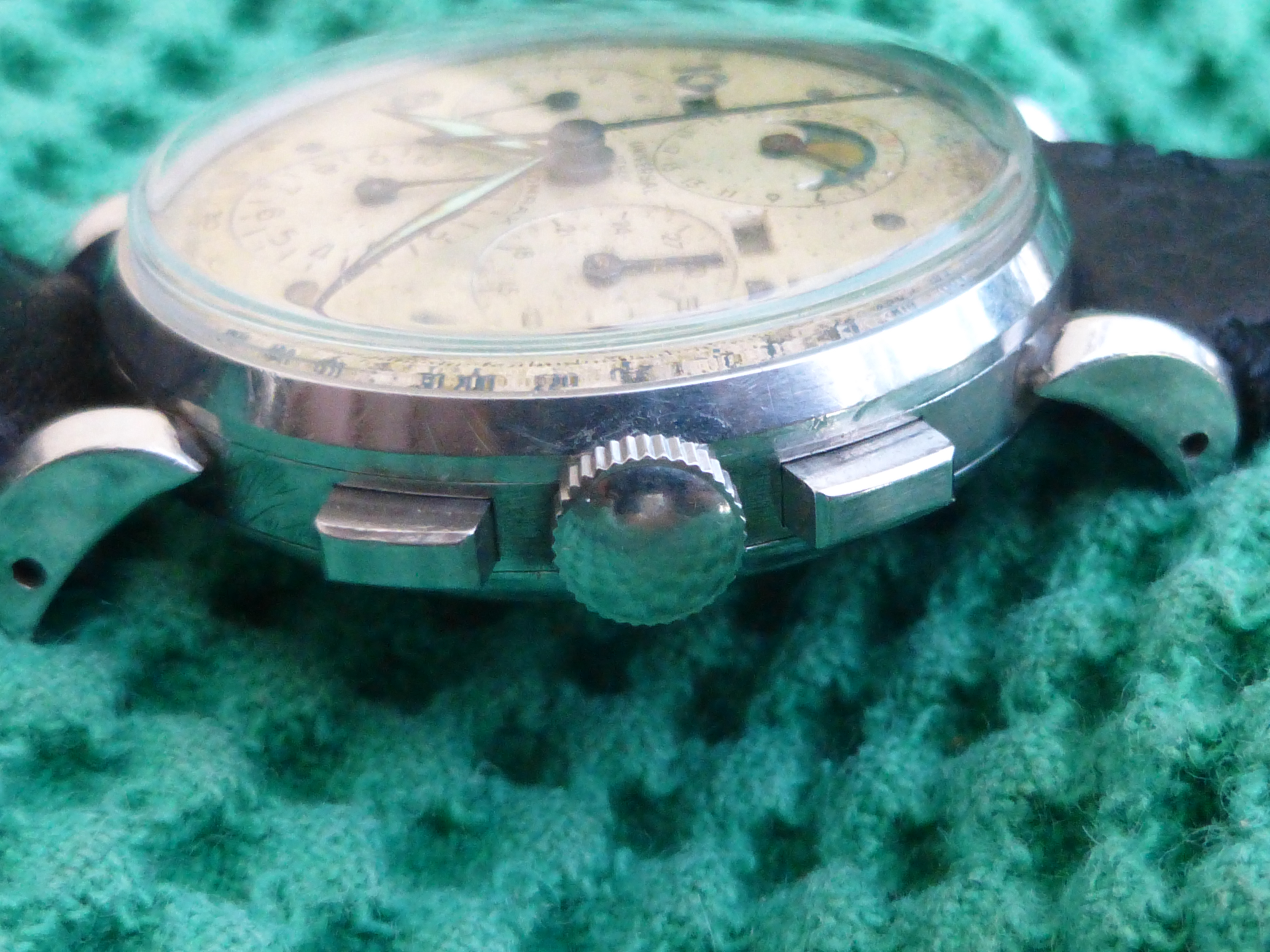

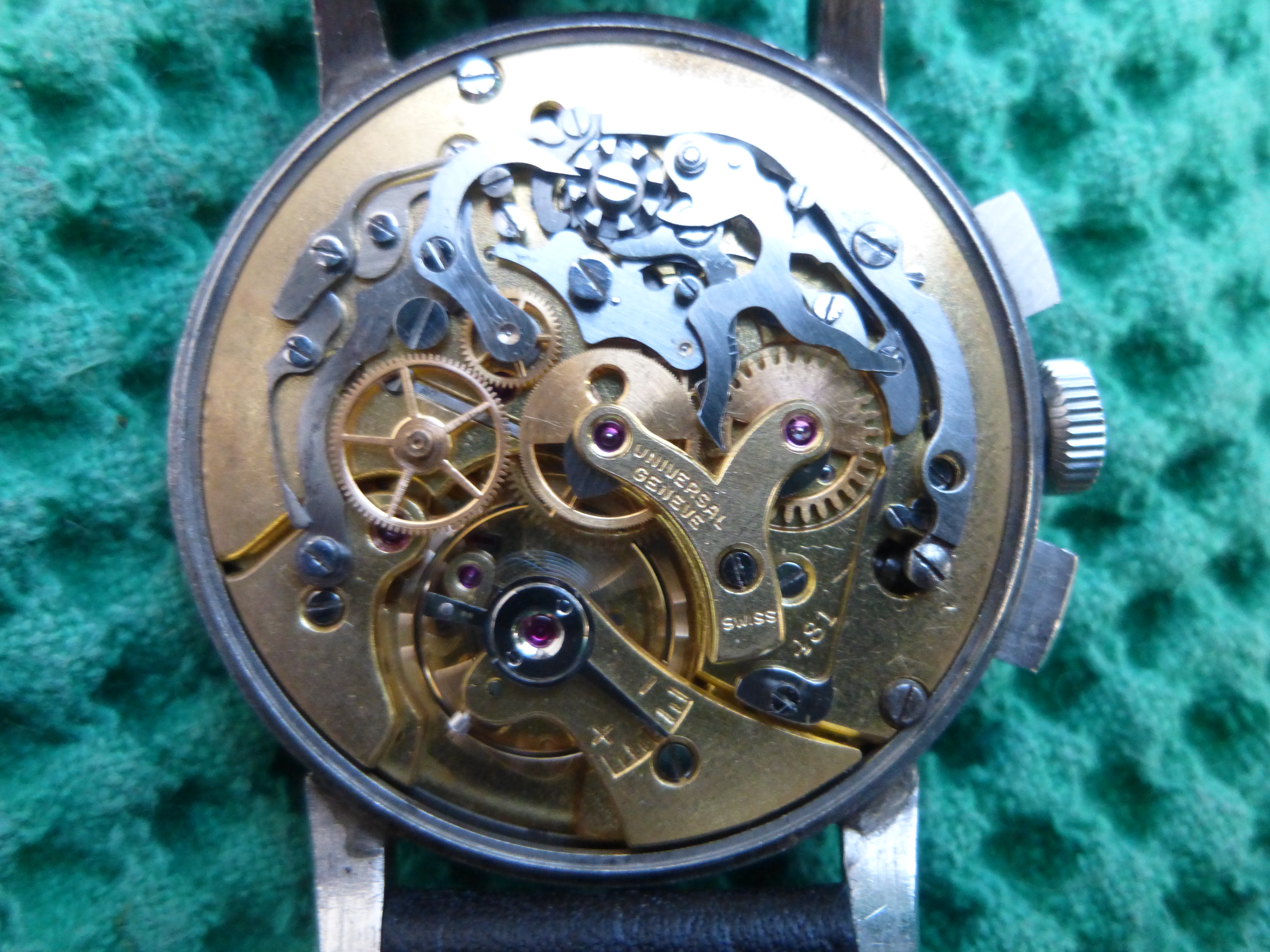

    I just add a picture of the crown and pushers and another photo of the movement.

    PS - that last movement shot is awesome!

    Nice find, movement and case are in exceptional condition, the side photo showing the pushers and their crispy edges is a killer
    congratulations !
