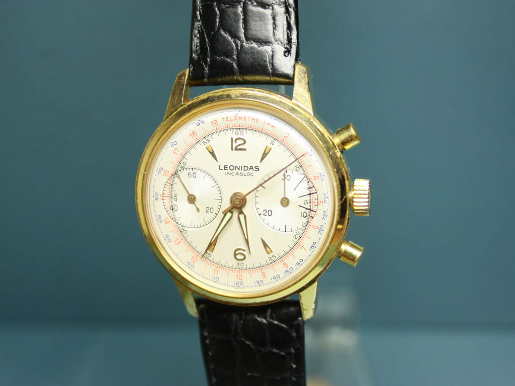

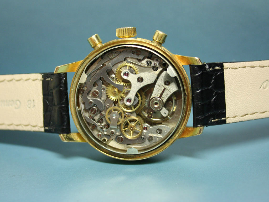

  1. JimInOz Melbourne Australia Jan 27, 2014
    15,476
    32,331
    Dial = Leonidas + Incabloc.
    Movement = Landeron 51 (?)
    Incabloc??
    :confused:

  4. ashleysteadman Mar 13, 2014
    541
    455
    Hi Jim, possible dumb question; Are you asking what an incabloc is? Or are you asking why it's mentioned on the dial (when the movement doesn't appear to have one)?

  6. JimInOz Melbourne Australia Mar 13, 2014
    15,476
    32,331
    Sorry for the vague post, at the time I was pre-occupied with other stuff and not on the ball.
    As Ash mentioned, I was questioning why the dial is marked INCABLOC but the movement clearly isn't.
    Obvious re-dial?
  7. X350 XJR Vintage Omega Aficionado Mar 13, 2014
    12,590
    29,841
    No, I don't think its a re-dial per say, more like a dial switch.
    The Landeron caliber 248 is based on the caliber 48 and some derivatives of this do have INCABLOC shock protection.
    There are plenty of these NOS dials floating around and will fit the many variations on the base caliber.
