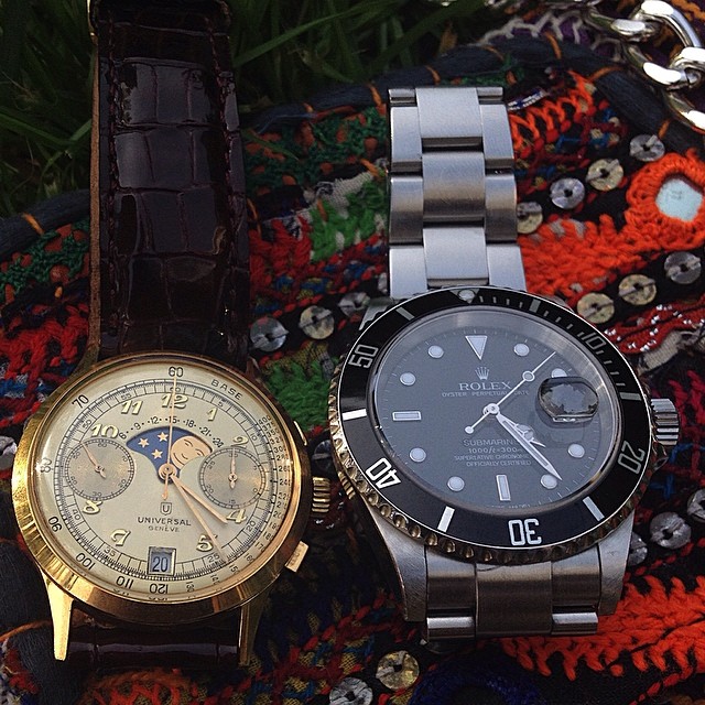

    So Instagram user @lovewatches has posted this really wicked moonphase... any idea what it is, what reference it is,where I can find one and when??
    Thanks!
    Bill
  2. woodwkr2 Mar 21, 2014
    1,366
    819
    Hold onto your wallet.
    I've never seen one like that before. The Universal signature isn't correct, though, nor are the hands consistent with their typical catalog.
    Also, why is there a ?date counter display above the moonphase window? It doesn't appear to count up to 31 and there's a proper date window at 6 O'clock. If we call it a power indicator, there's no hand.

    Woodworkr2, I'm not buying it, was just wondering what the hell it is. The owner says it was an ultra rare piece made only for the Italian market?
    I imagine that the numbers above the moonphase are related to something else, as they don't seem to be associated with any particular hand.
  4. LouS Mrs Nataf's Other Son Staff Member Mar 21, 2014
    6,713
    18,259
    They are related to the moonphase. The top of the moon itself is the pointer - in the pic it is pointing to about 22. They are missing the "3" and the "27" because the top of the moon is obscured on this dial cutaway.
    I doubt it's a franken. Looks perfectly authentic to me, although a more recent vintage than the ones we usually discuss.

    LouS, yeah he says it's some 80s model, but that's as far as he knows. I like it though...

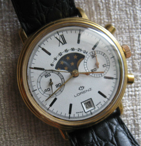

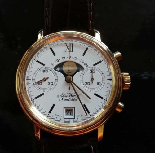

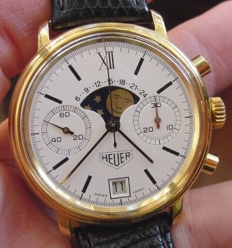

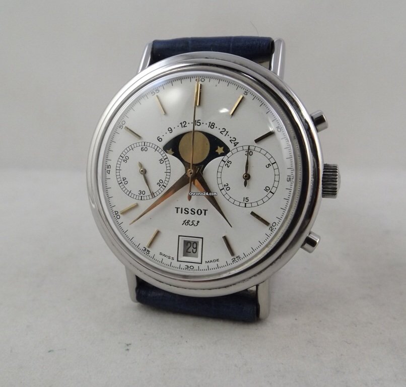

    So here's what I've discovered.
    The movement is a Valjoux 7734 with a moonphase complication (obviously) --
    I've not been able to drum up any other Universal Geneves, but I've found a Heuer, Tissot, Lorentz and Neuchatel that not only use the same movement, but also moonphase dial. I'm guessing it's from the 80s but could be wrong about that. Here are images of the different watches I was able to dig up with a cursory image search. Still haven't seen another UG like that one which, in my opinion, looks way better than these... assuming it's real.
    B

    So far, I like the UG and Tissot. The styling looks like 1980s or early 90s to me.
    Can't wait to find out...

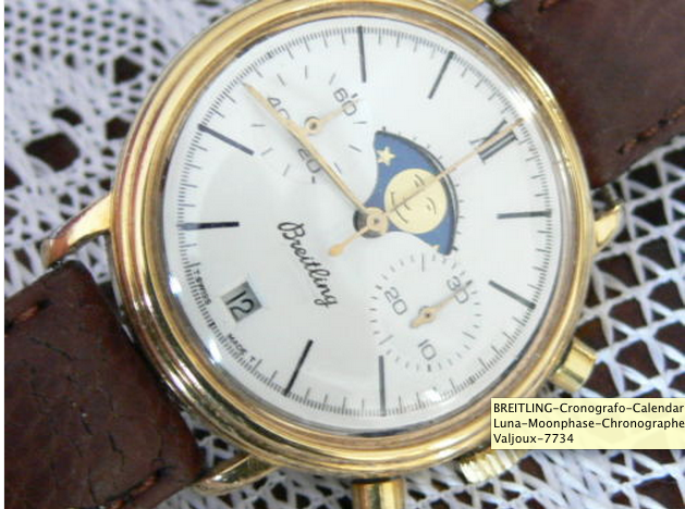

  18. woodwkr2 Mar 31, 2014
    1,366
    819
    The Breitling with the happy moon is 38mm.

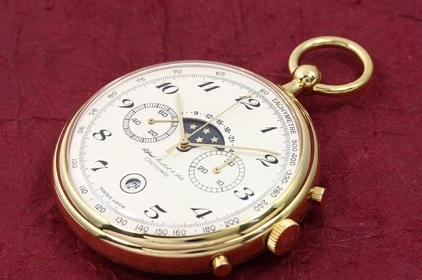

    There's a pocket watch version from 1992 (when apparently, there was a helluva lot of creativity in the Swiss watch industry) Screen Shot 2014-03-31 at 10.15.30 PM.png Screen Shot 2014-03-31 at 10.15.42 PM.png :
