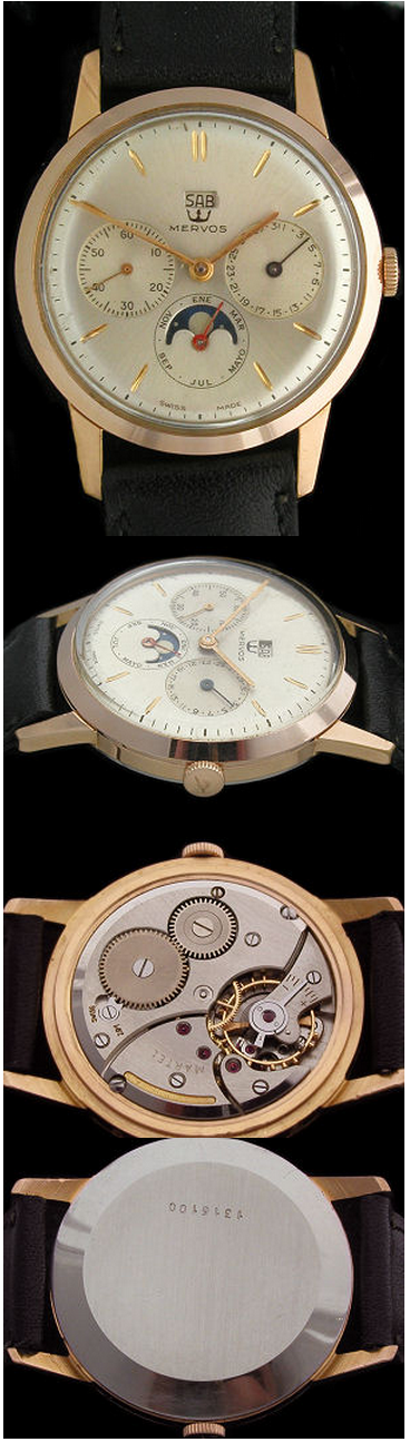

    The engraving of "Universal Geneve" on a calibre 291 is typically curved and follows the contours of that bridge. Notice that this engraving is straight across. Combined with the fact that it has had something scrubbed from the side of that same bridge leads me to believe that this piece began its life as a Mervos and was later "converted" to a Universal courtesy of some engraving handiwork and a redial.
    As Lou pointed out, there's only one correct hand on this piece.
    I'd stay far, far away.

    This is how it likely began life, courtesy of Farfo:
    There's nothing wrong with a Mervos branded piece, and as was pointed out, UG came to own Martel. Shame that someone ruined a watch in their efforts to "upgrade" the branding--though from the looks of the movement, perhaps it was already trashed.
