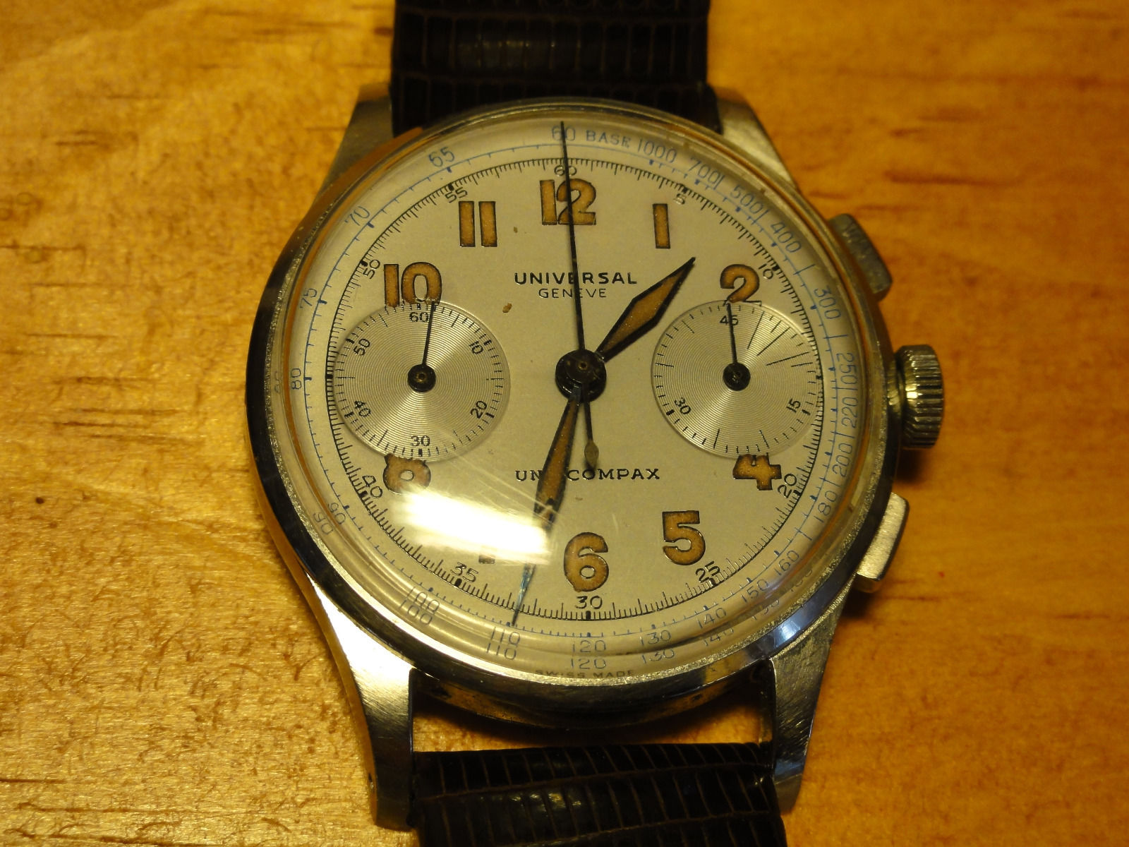

Beware of This Uni-Compax on Ebay

    I do not share your opinion. The dial looks original to me.
  3. X350 XJR Vintage Omega Aficionado Nov 23, 2014
    12,619
    29,916
    Not a UG guy, but the printing on the dial is way to crisp to be a redial, looks perfectly original to me.

    We are always calling out redials and frankens on this forum. And on a lot of other forums. These kinds of discussions are probably the single largest category of posts here. Authenticity is one of the main issues that a community of watch enthusiasts discusses.
    The most salient atypical aspect of this dial is the inking - it beads above the surface of the dial in a way that looks not at all correct to my eye. UG subdials of this era also typically use the three with the flat upper line as well as a four with little flat top as well, as in the minute track of this watch. Concur with redial.

    I still do not agree but it is often difficult to judge the dial just from the scans. Seeing the texture of the background would be helpful. I have seen original dials with ink applied thick above the surface of the dial. The ink here is very precise and uniform. I do not see any pitting. It stays in straight lines and the lines are of uniform width.

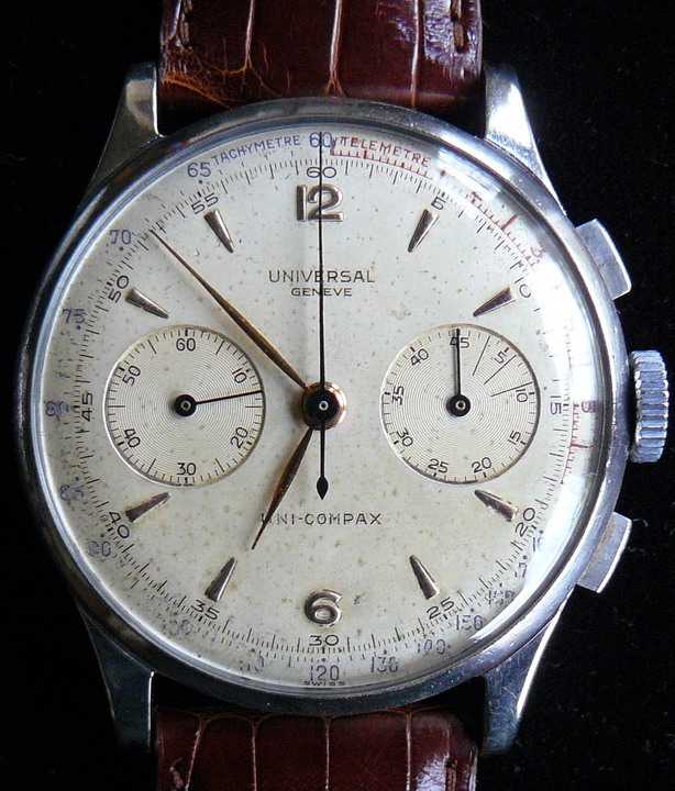

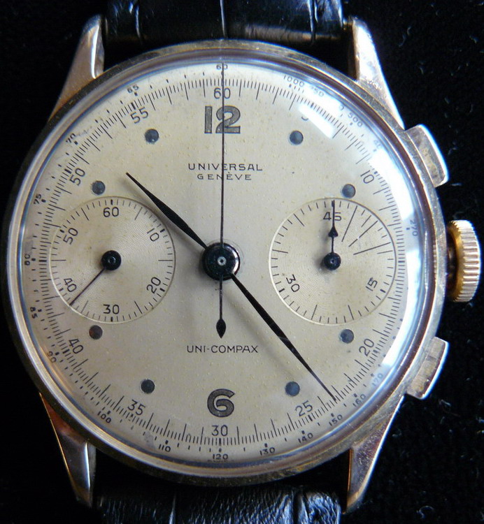

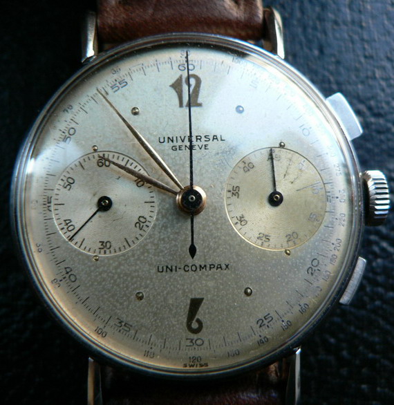

    Would have been more persuasive if you had thrown in at least one Universal Geneve.
    Universal Geneve 285 18 K Uni Compax 2_resize.jpg Universal Geneve Uni Compax 2.jpg Universal Geneve Uni Compax acier C 287 1.jpg

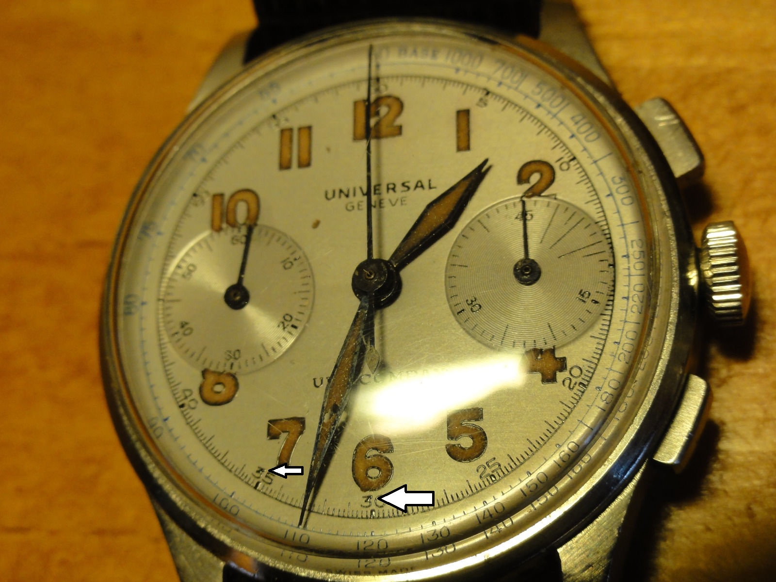

    Disagree here too. Here is another picture from the listing. I have indicated a couple areas of conspicuous overinking that I regard as unlikely to come from the manufacturer.
    I will add that many UG redials are done to a pretty high standard, as -- as for IWC - the factory cliches were available to a few redialers.

    you are making a good case :) not definitive in my opinion yet...

    The bold overinking and indices encroaching the subdials are signs of a redial. If you look closely at the subdials, you'll also notice the edges are soft - which is also an indication of a redial.

    Yup! And keep on posting your findings... and calling out the redials as you see them. Then we can all learn something and enjoy the debate. Though in this case, there's no doubt that this is a redial.
